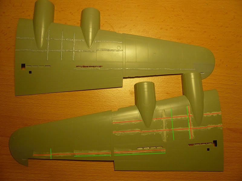

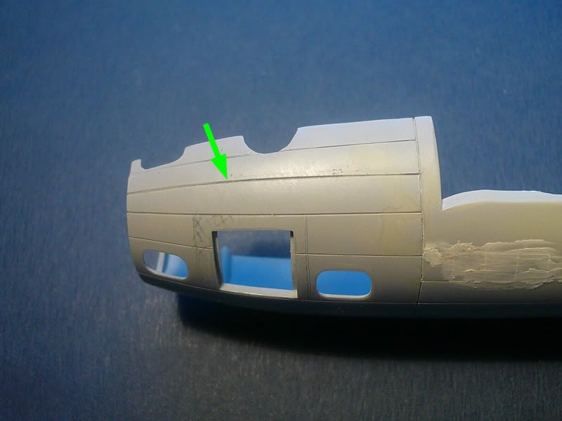

Příspěvekod Kormos Peter » 09 říj 2008, 09:34
Hi Guys,
Finally, I managed to get a copy of the 3 pages from Revi #24. The sad news is that I think the drawings there are not correct in many respects. Although the drawings look really attractive for the first look, they are not correct in therms of panel and rivet line details. After checking Aero Detail, Squadron, Verlinden, AJPress, Detail & Scale, Osprey, Warbird Tech Series and other less known B-17 publications' line drawings, I can say that most of them are wrong and has a big tendency of copying each other's errors. Unfortunately Revi#24 drawings are no exception either. I base these conclusions on real time photos taken during B-17 restorations, namingly the currently running Memphis Belle, Champaign Lady restorations and other walkaround type photos of this plane available on the Net.
Aero detail has really nice internal structural drawings of the Fort, but fails to have a correct line + rivet drawing ... just like in rest of their booklets. Still, those internal structure drawings are quite useful, and I recommend this book to every enthusiasts. To my knowledge only AD, Osprey and Revi has drawings with rivet detail and I think only Osprey has the most correct one but still not a flawless drawing.
Anyway to sum up the lengthy description above, here are some photos of of my model after the first panel line corrections. Red highlighted ones are wrong ones, the green ones are the new ones I scribed in. Please note, that even my model in the photographed state might not be 100% correct, but tried to achieve the best possible based on the photos I had at hand.
Regards,
Peter
